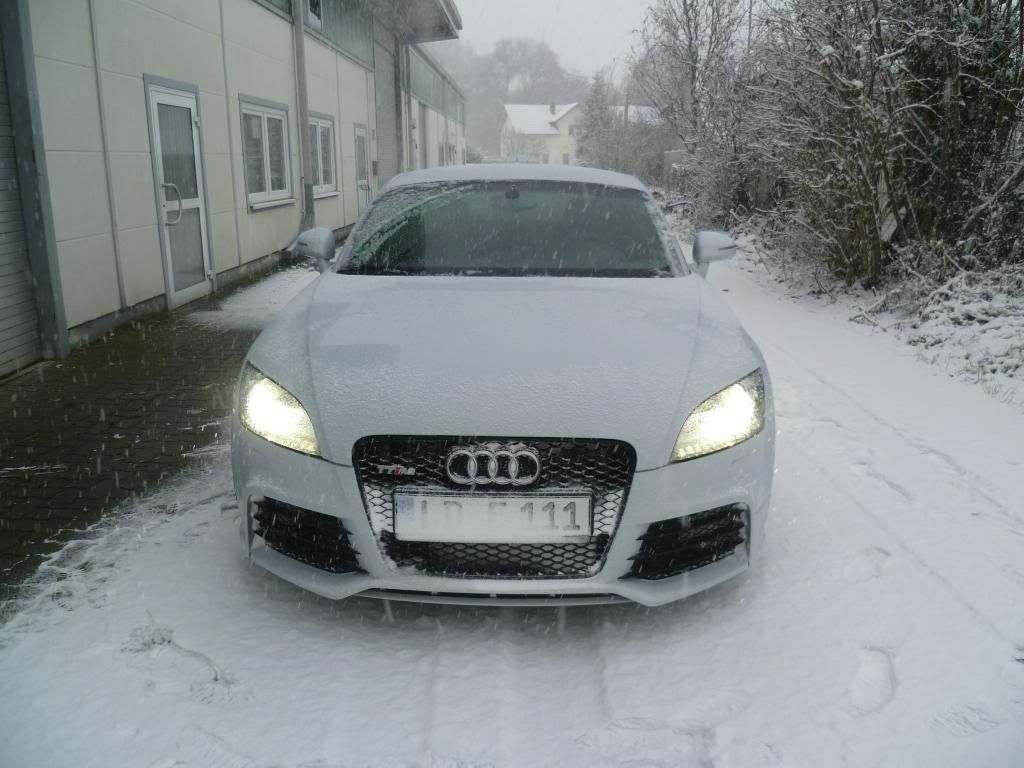

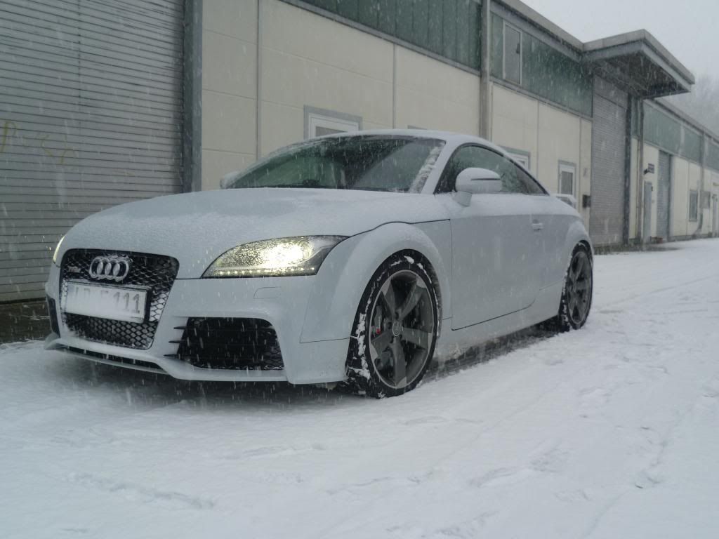

Audi TT RS.

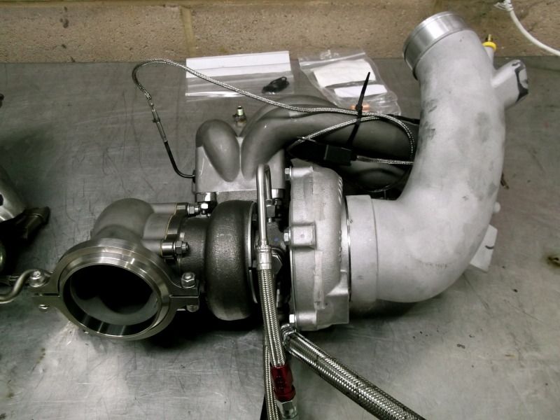

  • APR Stage 3 "Pre V-band" T3.
    Standaard turbo vs APR stage 3.
